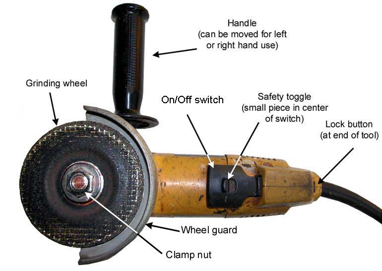

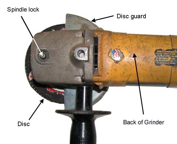

ANGLE GRINDER
What this tool is primarily used for:
Probably the most versatile tool you will own. The Angle Grinder can be used for removing rust, grinding excess slag, or grinding down weld beads. Wire wheels, cutting wheels, sanding discs and flap wheels can all be attached to the grinder for different applications.
Available in two sizes, 115mm & 230mm, size refers to the disc diameter. The smaller grinder can easily cope with 99% of your tasks. The only exception will be if you need a deeper cut, as the depth of the cut is restricted to under half the disc diameter.
Always use the correct disc for the job your doing, failure to do this can cause the disc to shatter.
ALWAYS WEAR APPROPRIATE SAFETY CLOTHING WHEN USING THIS MACHINE
SAFETY FOR THIS MACHINE:
DO NOT modify machine to cut without the safety devices. Guard should be used at all times
ALWAYS direct sparks toward the floor and away from other people and yourself
INSPECT the grinding wheel for cracks or flaws before use. If a crack of flaw is evident, the wheel must be discarded
AVOID bouncing the wheel or giving it rough treatment when in use. If this occurs during operation, stop the tool and inspect the wheel for damage
ALWAYS KNOW what type of metal you are grinding
ALWAYS unplug this tool before changing discs or wheels
THINGS TO REMEMBER WHEN USING THIS MACHINE:
Always set this tool on its back when not in use or when grinding wheel is coasting to a stop
When using a depressed center grinding wheel, hold the tool so that an angle or about 10º exists between the wheel and the work piece
Do not grind on the very edge of the wheel or use the tool flat on the work piece
