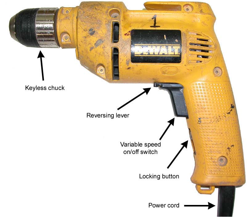

The Electric Drill is used for boring holes and driving screws into various materials. The main advantages of the Electric Drill over the Drill Press: there is almost no limit to where holes can be made in material and the Hand Drill is very portable. It should have a reversible motor, operated by a lever, speed control knob a torque setting control and a locking button to hold the switch in the on position.
